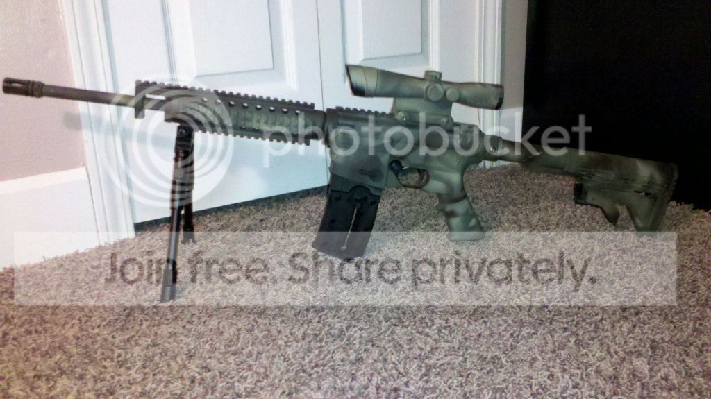

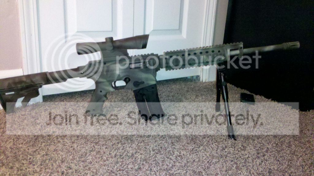

Re: Frustrated over optic mounting....
Heres some pics of my Tactical .22 - Love the gun, the only thing I dislike is the damn magazine and its capacity.
