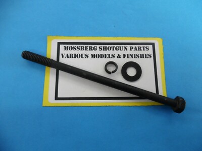

The ATI stock I do not believe uses a factory stock bolt as the angle would not match -
I've purchased Mossberg parts from this seller many times he ships fast and OEM Mossberg parts - $10 for a stock bolt with washers, and have bought Hogue before from this seller -

Is this your gun with ATI stock? If so, you have the long action tube already, no adapter nut is necessary, but that straight back M4 stock from ATI in my opinion is horrendous for function, recoil mitigation etc- and yes, you would need the Ebay link for a factory stock bolt/washers set when you remove it as that does not use the factory stock bolt-

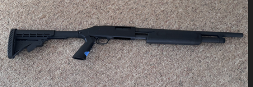

Here is a picture of mine.

Yep thats the one - straight back M4 stock with no drop so you cant get a good sight picture - very annoying on a shotgun
Order the fiorend nut adapter too - based on your photo I can almost guarantee from the picture 99.9% positive that is a 6 3/4 action tube -
