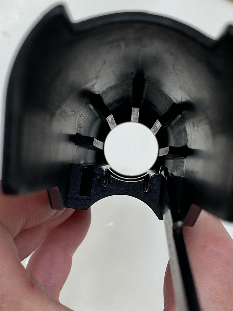

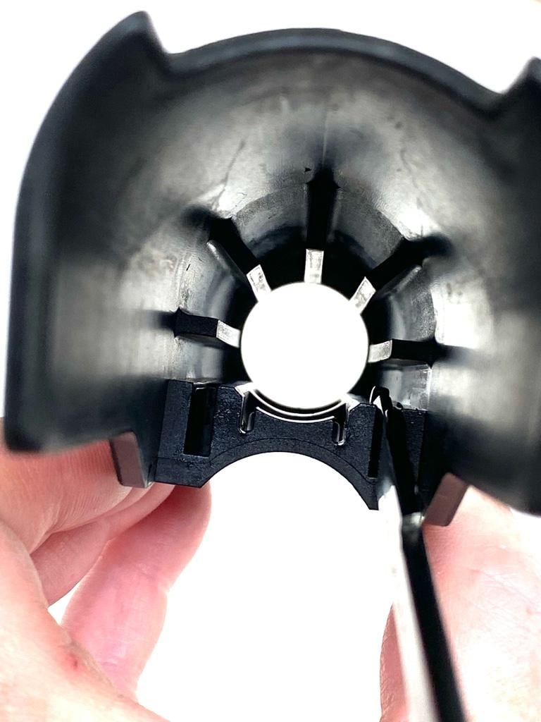

Hi all. New to the forums. I recently purchased a 510 mini (20ga) and shot it for the first time this weekend. I had trouble loading shells into the magazine tube. The shells would go all the way until the metal cap, but refused to go over/past the cartridge stop. After struggling for several minutes I found that pulling the forearm ever so slightly allowed the cartridge to push fully into the tube. I have not yet fully stripped and reassembled the shotgun but will try to do that tomorrow or Wednesday and see if that addresses the issue. Is there something that locks the tube to prevent loading that might be causing this? I think my issue is different than the linked thread at the top of this thread, as I don’t have issues loading shells from the tube to chamber, just into the tube itself. But perhaps they are similar issues (an overly bent cartridge stop)?

Also, the inside of the mag tube is sharp (past the spring “cap”). I found when pushing hard to load the shells the over time my thumb was getting nicked on the sharp interior. If loading was less of a struggle it wouldn’t be an issue.
Is it always sharp? Can the inside of the mag tube be filed to smooth it out a little? Or will that cause other issues?

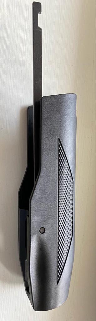

so I field stripped my 510 and I am missing a pin that holds one of the levers that attaches to the forearm. My forearm was always a little wobbly, but I just assumed it didn't have a good tight tolerance. Now I can see it was missing a pin. I will email Joe Zakher to see if he can help.

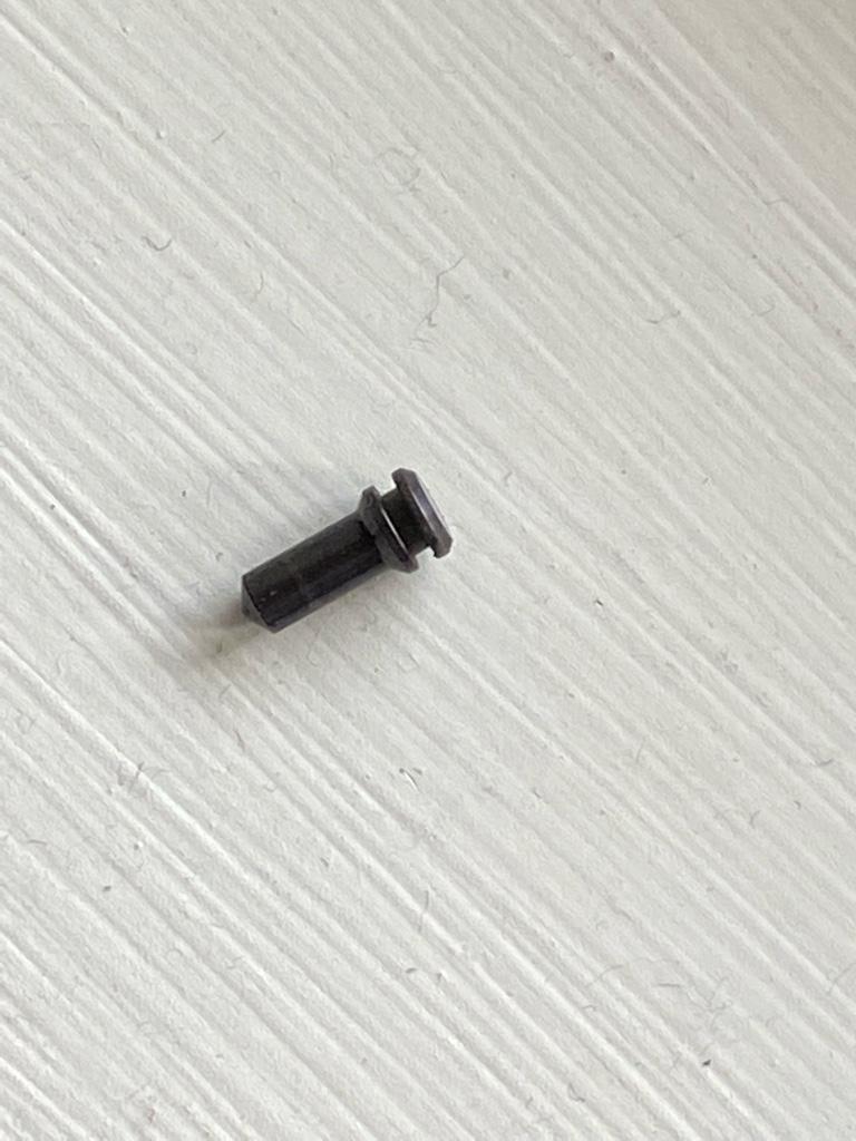

Thanks Bobster. It looks like it’s a pretty special pin.
Bobster
.30-06
Yup, I'd say that is special... :( I'm not familiar with .410 slide tubes. Is this a metal tube with the bars coming off of it and foreend slides over and is held on with a ring nut? Thanks for updating, also! :)

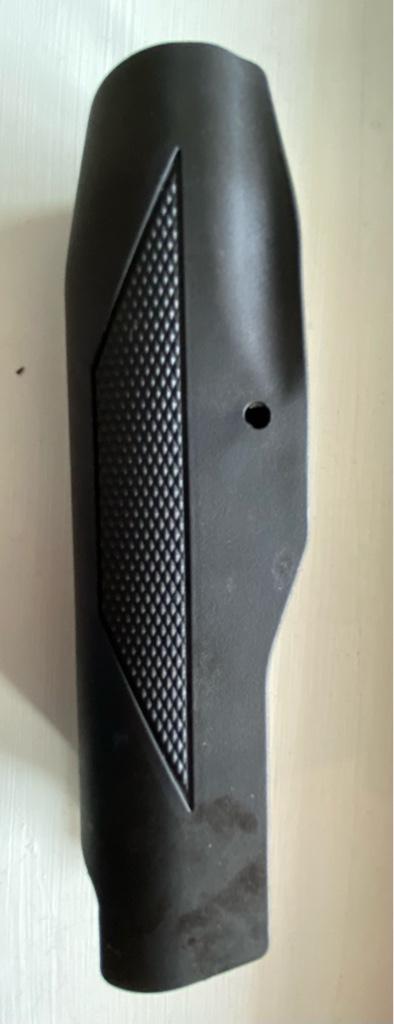

Actually this is a 20 ga. Here are two additional photos. One of the forearm (showing hole where pin goes) and another showing the flat rail (rod) that attaches to the forearm by the pin. There are rails on both sides. One of the 2 rails was missing the pin. So the rail has a guide on the inside of the forearm, but without the pin it’s loose. I’m actually surprised it functioned when loose.

That looks like a pinned plastic foreend--no metal slide inside. So the pin presses out from inside to secure the rail? Know anyone with a lathe? :) Or try Havlin or Numrich. I posted a pic of 12ga above, refresh to view.

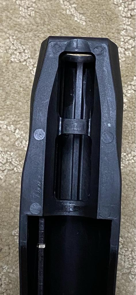

Here are 2 additional pics of the forearm. It is all plastic. It’s molded on the inside to hold the rails. It’s somewhat dark in the photo, but if you zoom in you can see it more clearly. The pin inserts from the outside pushing in. To remove the pin you push from the inside to push it out.
Edit: I added another pic with adjusted exposure to see the plastic grooves.

It looks fine on inside. Either they forgot(?) to put a pin in during assembly or it worked it’s way loose and fell out post assembly. The internal plastic guides and all the other parts pretty much hold it in place fully assembled. It’s just without being pinned it won’t “slide” properly.
