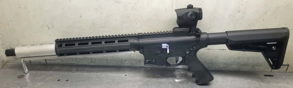

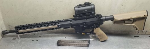

I couldn't vouch for the BOP but I have a Raven on my S&W M&P 15-22 I use to shoot steel. It is a 1.5x prism with circle/dot black reticle. It could also be red/green but I don't even keep a battery in it... :) It was about $55 to my door a few years ago. Once I got it sighted in I haven't had to mess with it except for minor zeroing with a new batch of ammo. I DID have to grind the screwdriver nub off the top cap because it was chewing up my scabbard but there is another on the side I can use, if necessary.
I've thought of getting another Raven for the AR-9 (they still have "refurb/open box") but will probably keep the 15yo Tasco ProPoint on it... ;)

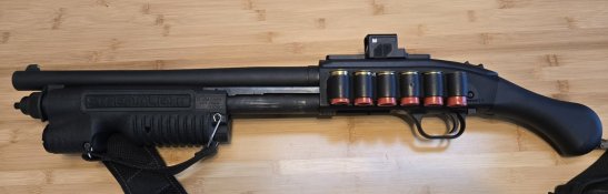

First, it does fit well on the Shockwave (with the Crimson Trace Laser Saddle). Monstrum included enough screws in the box to supply a small hardware store, so finding the correct fit was easy. I can see where this optic (if it holds up) could be immediately beneficial in target acquisition speed and accuracy with a Shockwave.

I scraped up 19 3" magnum rounds (5 slugs, 5 defensive 00 Buck rounds, 9 turkey loads) to test the BOP on my 500 I didn't have the guts to test these loads on the Shockwave. Anyway, it held up better than I did. Once I got it zeroed - or as close as my shoulder would allow me to get it - I ran the rest of the rounds...and the BOP held zero. I fully expected it to fall apart, but it didn't. I was definitely happy with that. Of course, it might crater tomorrow, but so far, it's hanging in there. For now, it's a winner.
