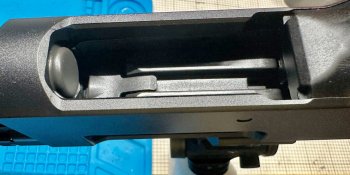

Ernst, this trigger assembly uses 2 housing pins instead of 1 like on the regular 590 @ 590A1 shotguns. (See the attached schematic)Bobster, I think the one feature I like best and have advocated for years that Mossberg adopted is the enlarged loading gate port. Many of us have taken a file to our older Mossbergs and basically done what is now standard on the 590R. It really does make a difference if you're tactically (combat) loading while on the move or without looking at the port. Plus the smoother and relieved foward ramp certainly saves your thumb.

I do like the new profile of the trigger. I wonder if it was designed in house or bought off from a supplier? Would like to see if it's a retro fit into a Shockwave.
Thanks White Oak for all the insights. If you tear down the gun could you look at the trigger and see if it has any identification marks?
You’re welcome.Guess that answers that question. Thanlks for the info and diagram.
