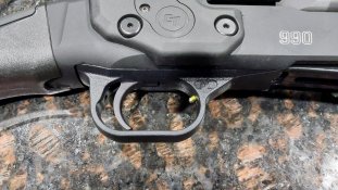

The other interesting upgrade is a "cocking indicator" located on the forward trigger guard. While I guess this is nice I'm not sure about it's utility. As I read the manual it does not indicate if if the chamber contains a shell or not. So what's the real purpose? Another lawyer add?

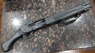

Finally picked up a new Mossberg 990 Aftershock semi-auto 12ga "other" firearm, that was also submitted via e-form to be SBS'd. Prior to the stock install, I'll be comparing it to some of the other boomsticks in the collection for a first-hand feel of how it runs with all 12ga varieties...
More details to follow as I unpack from the MTT op we recently returned from. I'll have more time for extra pics and range report...

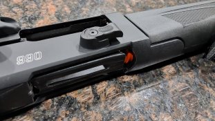

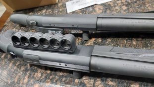

Pics of the new 990 aftershock with my 940 Pro Tactical...

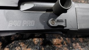

Notice the "cocked trigger" indicator from the 940 is carried over on the 990. As these are both semi-auto's, this is actually a good thing (not sure if the 930 had this...)

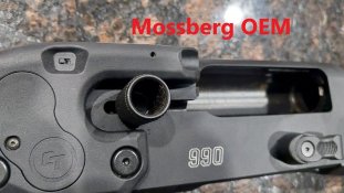

Notice that the bolt release on the 990 is now "reinforced" on the 990 with an exterior frame. Since I have large hands, I've already swapped out the OEM "large" charging handle" for an even "larger" enhanced charging handle for the 940 Pro from GG&G...
The plan is to order another Mesa Tactical 940 Pro side saddle to install on the 990 Aftershock since their trigger pins are in the same locations...
As you can see, the 990 Aftershock does not have the factory optic cut out in the receiver like the 940 Pro but I'm sure that may happen with the potential 2.0 model...

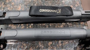

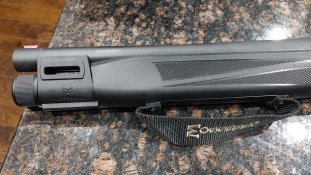

The forearms/fore ends are the same except the 990 has the same handstrap of the 590 Shockwave screwed into it...

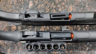

Same magazine tube follower between the 990 and the 940 Pro but the shell lifter on the 990 now has been milled out in the center...

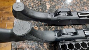

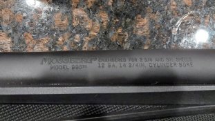

I haven't performed a complete tear-down yet, but the 940 Pro and 990 Aftershock have two different gas systems. As I did the SBS e-form submission, I had to refer to my 590's for stock lengths due to this difference for stock option for the 990. I'm going to use a Flash-5 from TactaLoad like I did for one of my 590 Shockwave SBS's once the Form 1 returns approved. Anyways, the 990 has all of it's gas system in the receiver (like Remington's TAC-13) so the new "bird's head grip" installs the same as the 590 Shockwave. The 940 uses the stock in it's gas system's operation...20250525_001358.jpg

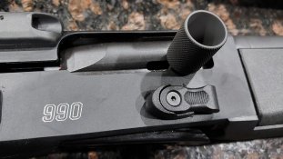

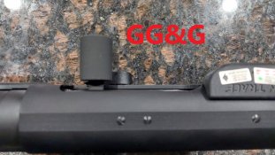

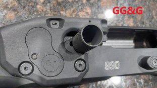

Like I said earlier, I've already swapped out charging handles and the new/larger GG&G handle fits & functions perfectly with the new Crimson Trace side saddle laser housing... 20250525_001127.jpg20250525_001145.jpg20250525_000819.jpg20250525_001034.jpg

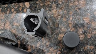

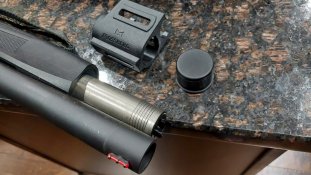

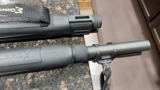

The new barrel clamp for the 990 is made of polymer like the OEM clamp for the 940 Pro, but it at least is a bit more "beefier". Not sure how it will hold up to heat with an attached accessory on it's 3 M-Lok slots...20250525_003057.jpg20250525_003108.jpg

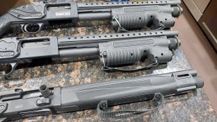

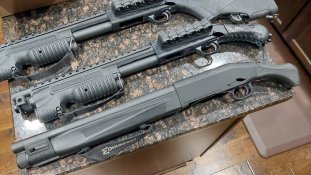

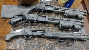

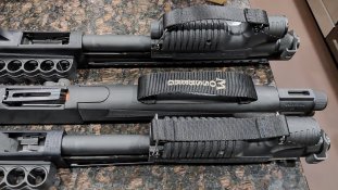

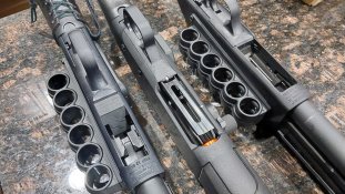

Extra pics of the new 990 Aftershock with a couple of 590's (regular and SBS)...
I've got mini-shell adapters installed in these Shockwaves (one is a 590S that was "upgraded" with a Defender Tactical Universal Minishell Adapter for ALL shell sizes, and the other is using an OP-SOL adapter), but the 990 Aftershock is a complete "No-Go" for mini shells due to the carrier design. Too bad... 20250525_002826.jpg20250525_002831.jpg20250525_002716.jpg20250525_002848.jpg

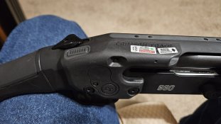

Update... As I'm known to add on creature comfort items, I was curious if the enhanced ambi-safety setup from NDZ would work properly on the 990 Aftershock WITH the new Crimson Trace side saddle laser. The new OEM safety is nice and is like the new OEM safety on the 940 Pro, but I need something a bit more substantial for my "Flintstone" thumb(s)...20250525_204720.jpg
There is just enough clearance for the new safety to move smoothly by the Crimson Trace laser. Nice...

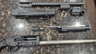

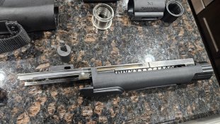

If at some point, if you remove the forend could you take some pictures of the gas system. Some of us are trying to see if it's an adapted Turkish design. Certainly looks that way from the parts list.

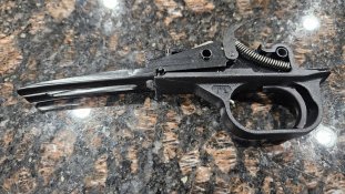

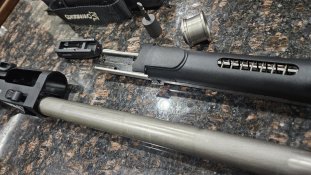

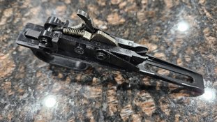

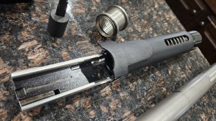

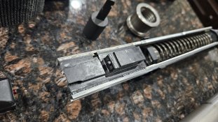

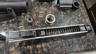

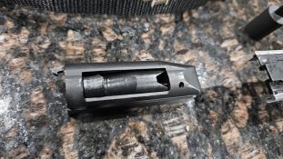

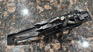

Very basic gas system with not a lot of user "adjustments" to tune. I can tell the 990 will not be as smooth as the V3 system in the TAC-13, but it will still kick less than a pumped 590 Shockwave. Simple bolt and trigger assembly (no over-travel screw, even though owner's manual says so)...1000008515.jpg1000008516.jpg1000008517.jpg1000008518.jpg1000008519.jpg1000008520.jpg1000008521.jpg1000008522.jpg1000008523.jpg
