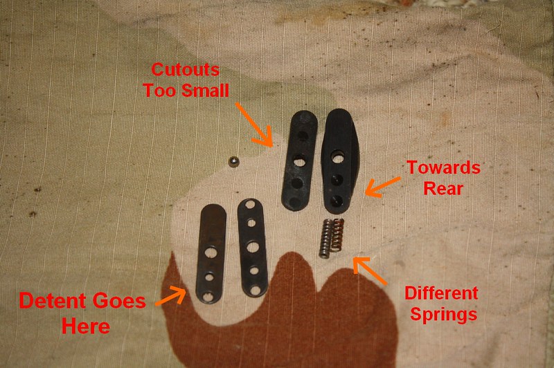

The safety should go forward under recoil, not backerds. If the safety goes to rear after cycling action it is because the bolt is smacking the safety block. In your case it sounds like the issue is isolated to the safety assembly.
The safety button should always have the steel plate under it. This is because some safeties have cutouts that are virtually nonexistent. Most safeties and plates have four holes cutout; these can be oriented in either direction. Some safeties and plates are only cut on one side. In this case both the safety & plate must have the cutouts to the rear. The ball detent must have a place to go.
The spring is about .375" and the hole is about .30". Different length springs do exist.
