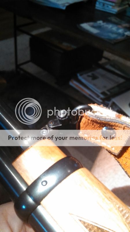

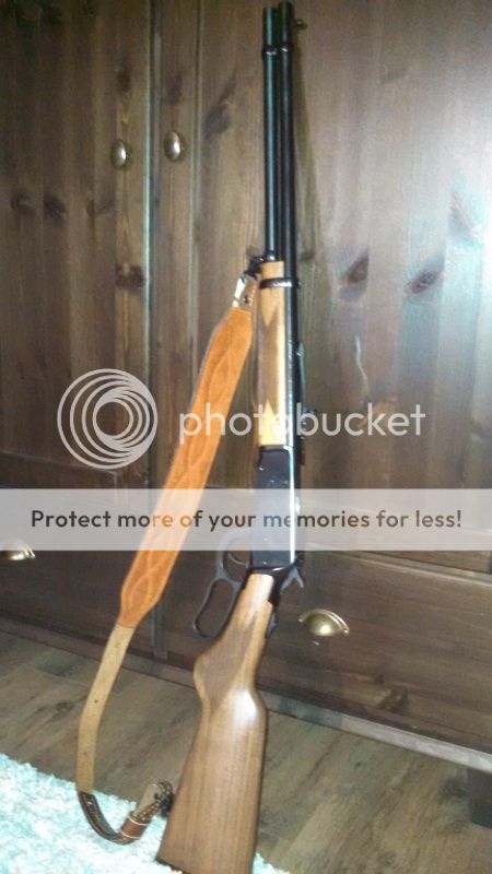

I installed Uncle Mike's QD swivel kit(1391-2), it's a perfect fit. They don't list the 464 on the description, but the magazine clamp is right on.

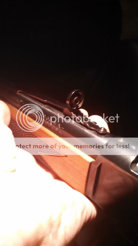

I also changed out front & rear sights....Marbles Bullseye on the rear & a KNS 3/8" hooded cross-hair on the front. No problems changing the front, but had a heck of a time getting the rears out & the new Marbles in the dovetail. Had some issues selecting the correct height for the front sight, but works great now. My only hang-up on the sights now is how the Bullseye stands up so high. I'd really prefer a flip-up peep for the rear, and looked for one, but everything I saw was designed to mount aft of the hammer(where our tang safety is). If I've missed one out there that will mount on the 464's dovetail or scope holes somebody let me know.
Jeff
http://media.midwayusa.com/productimages/880x660/Primary/612/612521.jpg
Here's a pic of mine with the Uncle Mike's swivel kit....
Front swivel split ring mount....

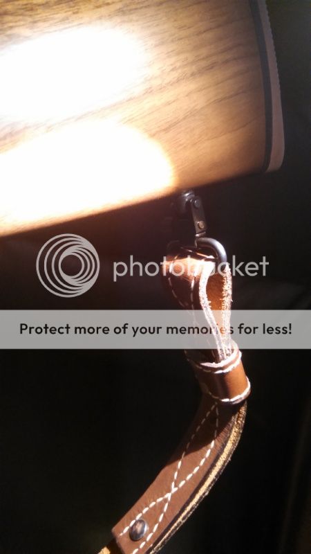

Rear swivel stud mount....
Oh, & here's that Marble's rear site installed. In order to sight it in with that shortest KNS front I had to raise the Marbles Bullseye up to the 2nd highest position...
You can see where I would really like to find a flip up rear. That Bullseye is way out there!

How do you like that bullseye sight.
I just installed Uncle Mike's QD super swivels (#1391-2) for a sling.
The front is a split barrel band for the Winchester 94 & Marlin 336.
It fits the ammo barrel of the 464 just right.
I drilled the stock for the back stud. OK (not perfect ;) no drill press)
