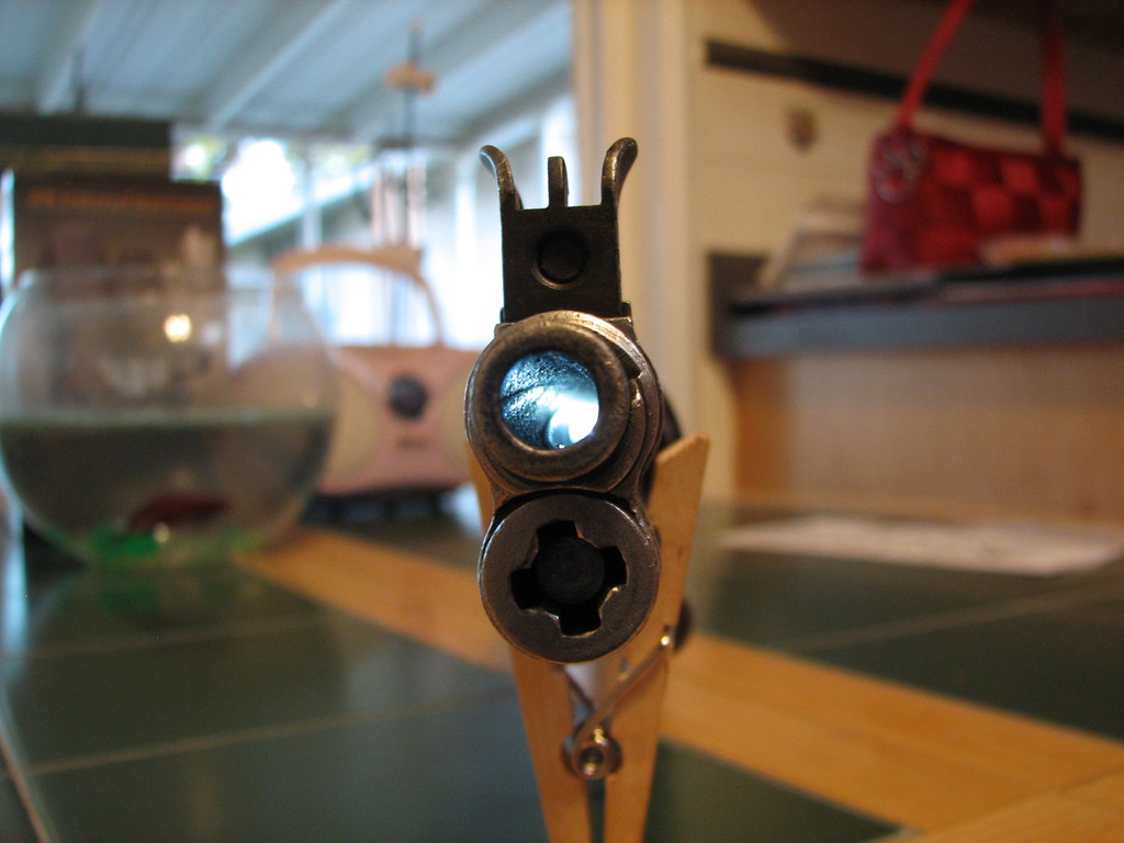

Things have really headed South on this little beauty, I did a thorough cleaning of the barrel, What I thought was old grease or something is a badly corroded barrel...
Needless to say, I am not pleased.

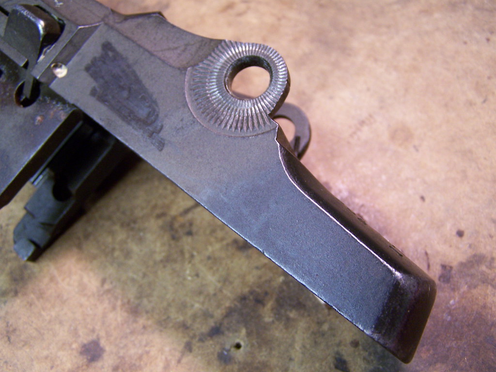

I also have found out the barrel is a Taiwanese refurb, and the One of the guys on the CMP forum asked if the patches and brushes were all black, Which he said is the Salts from the corrosive ammo, Which mine were.
Another guy mentioned this...
It's really hard to see on your barrel, but there is a faint "broken spoke" wheel marking used on Nationalist Chinese military stuff. I saw a bunch of these at Big 5 last year and many also had very faint Chinese characters on the left side of the receiver (some are very faint). That "touch up" area is exactly where those Chines characters would have been so it looks like someone removed them
Touched up area.
I have a new Criterion barrel from CMP that is being processed, I'm a little bummed out that I didn't inspect it more before I bought it, My wife has been very understanding, Which has been great, I may send off all my parts to be re-parkerized as well as have the barrel installed through Shuff's Parkerizing
I am also working on the rust issue, I have used some auto body rust inhibitor on it to see if it will help.
