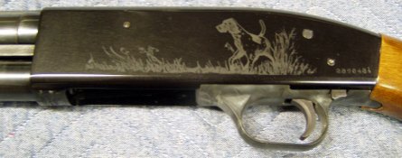

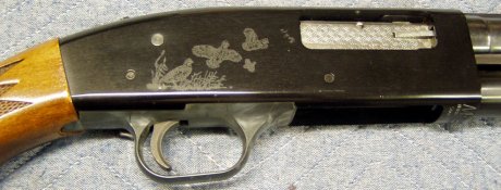

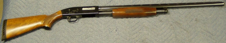

I’ve had this 500A now for 25 years. My dad let me skip school and we went and picked it off the used rack in a rundown gun shop. Still my favorite gun in the collection to this day.
However, I’ve tried now for a couple years to figure out which 500 it is. I’ve tried the normal Google route but have found mixed answers. It’s a standard field model with 28” barrel but has a gold trigger and factory engraved scrolling on both sides of the receiver. Gold trigger shows me it’s a pigeon grade, but the engraving is throwing me off. Serial number is P172xxx. Any thoughts?AE14E505-62EC-4473-B92A-262A2F567328.jpeg7CDA8290-FFC6-4280-AF4C-42F4D0A354AD.jpeg

Reinvigorating my question if anyone knows which 500 I have? Factory engraved receiver and gold trigger. 28” ported barrel.
Thoughts?

Here's some additional info for consideration.
You need to confirm but I think your gun has two aiming beads? One at the center of the barrrel and one at the muzzle?
If so, and given the other specifications of barrel length, porting and being choked this gun was likely built and marketed as a "Trap" gun.
Mossberg made some guns back then which were tailored to shooting either Trap or Skeet.
I do think the engraving is rolled vice hand engraved. But hard to tell unless I could actually handle the gun. The type of engraving used is a cost issue during manufacturing and typically only the very high end or individual custom guns were hand engraved. Just a bit of background on engraving - rolled engraving uses a curved plate which is rolled under pressure to create a 3 dimensional look. And there is absolutely nothing wrong with it. Beyond hand engraving which is both time consuming and very costly there are other methods used today including laser, acid etched and galvanic etching.
I have no idea as to the number of guns Mossberg made in this configuration but likely a run of a few thousand.
Hope some of this info helps. But the biggest issue is that you are enjoying shooting the gun.
