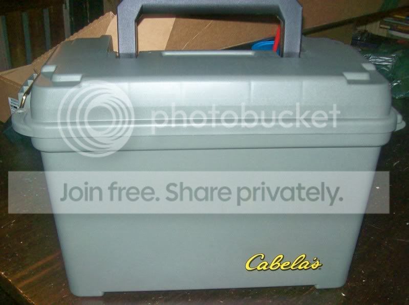

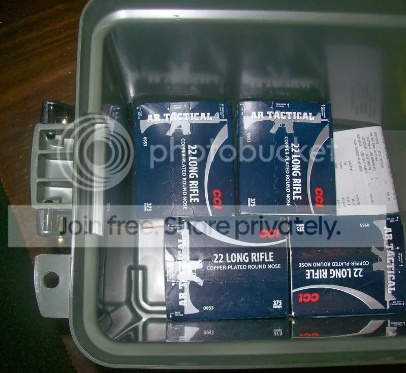

CCI AR Tactical .22 LR. Got 1500 rounds in a Cabela's dry storage box for $94.99+tax.

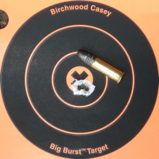

Got back out to the range with the plinker today. Took the .22 Mite to get some comparative results on target with and without the can. Put a coulpe hundred rounds down range at 50yds and most of the targets ended up looking like this one...
This was the best 3 shot group of the day, measuring 1/8" center to center...
From what I could see, there was no perceptible difference in POI whether the rifle was suppressed or not. However, the 38gr Reminton subsonic HP rounds grouped about 1.5" lower than the standard 40 grain Federal Target AutoMatch ammo. I re-zeroed the scope for the Remy subsonic and the targets pictured above were the result. The subsonic did seem to yield much more consistent results on target. I did have several FTE issues with the Remy stuff, but it still performed much better that the Remy 'Golden Bullets' I tried last week. I couldn't even get that stuff to load into the mag properly.

I tried the Winchester M22 this weekend. Box of 1000 rounds for about $50. I fired 500 rounds and out of 500 rounds I had one failure. Not sure if it happened in the rifle or if it was defective when I loaded it into the mag. The bullet had a half shaved tip.
So the math so far is this:
750 CCI AR Tactical 22LR fired = 0 failures (fired in dry conditions outside)
500 Winchester M22 fired = 1 failure (fired in damp/wet conditions outside)
1250 rounds fired with only 1 failure is pretty good no matter what.
I did note that the Winchester M22 is less accurate than the CCI AR Tactical rounds. I also noted that the Winchester M22 has various 'hot' rounds as I call them, some seem to really go "BANG" louder than others.
