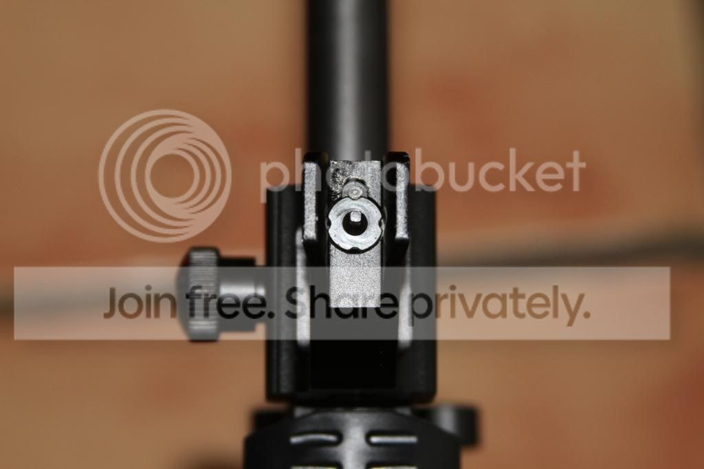

    I too have a problem with the "iron sights" on my 715T with Carry Handle. They were all going down and to the left, but when I zeroed in my red dot that's on top of the carry handle it was showing slightly high and I didn't have to adjust for left & right. This was done at 50 yrds.

    I called Mossberg today about my 715T flat top that is in for warranty repair because it shoots low and left. It has been there since the end of January 2013. They tell me mine and two others are waiting on new barrels to arrive from Brazil. Expected delivery date to them is 6 May 2013. After they get them they will work on the rifles and sight them in. Personally I question whether it is the barrel or not (I suspect the plastic body/rail setup myself) but as long as they fix the issue I'll be happy.

    Sorry to get back late on you guys. I have been busy at work and wasnt able to go to the range until yesterday.
    I got my riser and my scope is now zeroed. Ive been punching paper in 2" groups at 50 yards. Had to do away with the iron sights though. The iron sights wont zero no matter what i do. Still low and left.

    Hi, my first post about the sighting issue applicable to carry handle 715T's. (You can call me John, but I AM always "searching for Truth" just like everybody else here.
    When I received my 715T, I found the rear sight was WAY over to the right, almost to the end of adjustment. I thought "they never sighted it from the factory", no big deal. (Yeah, it shoots to the left for real)
    Then, after cleaning and oiling, I loaded it up with Yellow Jackets (the only thing I shot out of my S&W 6" revolver.
    (Even though I am 65,I have never owned anything but my dad's old S&W, so everything is/was new to me. Fortunately, my auto mechanic analytical and diagnosis skills helped with 25rd mag load and feed problem. I checked in HERE while waiting for my rifle to arrive, so I was up on what to expect from initial performance before I actually had the rifle. THANKS! THAT goes to everyone @ MossbergOwners. com!) The Yellow Jackets didn't want to load SLOWLY, but after removing a couple of jams, I let the action do all the work by just pulling it back and letting it go. (made me a little nervous with rim fire, as I suppose the slide is hitting the rim of the cartridge to load it) It finally loaded the first bullet and fired 10-15 rds before jamming. I switched Rem Sub Sonics ( not plated, lead nose HP) they ran pretty good, with an occasional FTL, FTE (suspect may have been the mag spring chafing on at least one occasion).
    With a good supply of Sub Sonics I attempted to sight in the rifle: ZERO @ 25 yds. (backyard firing range) ;)
    After finding the stock rear/front sight was not able to ZERO @ 25yds. (would have needed to be around .5 " higher rear sight), I called MOSSBERG:
    MOSSBERG asked when I purchased my 715T, I told them around late February-mid-March 2013.
    They IMMEDIATELY SAID, "Send it back. There is a problem with the BARREL."
    I haven't sent it back yet. I want to check a little further.
    My front sight is around 2.7 " from inside diameter of barrel to top of center post of front sight (near as I can tell). What is the height of the flat top front sight, anyone??? I'd really like to know!!!
    I think the front sight is too high (duh :D ). I need to see if the shot arcs off to the right or left after zeroing with a new open reflex sight @ 25yds. and see if it holds its line at 50 without going wide (or wild). I would expect a slightly high hit @ 50yds due to trajectory charts. Please let me know what else I might check out.
    I am not crazy to send it back having not had it and time to shoot for very long AND I need a longer range (50 yds.) to see what happens to the trajectory when ZEROED @ 25yds. If it shoots (follows trajectory) I might just keep it and just use the open red/green dot and laser until they know what the real problem is and offer an updated shell (sights).
